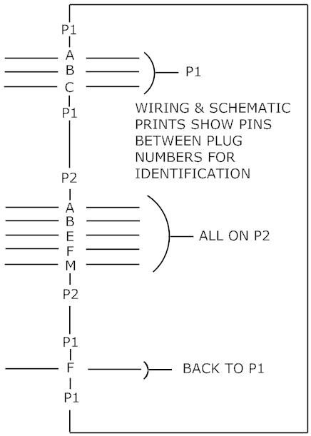

For the folks who aren't that familiar with reading wiring and schematic prints.
Every aircraft manufacturer "brackets" pins between plug numbers. Pins will always be shown between plug numbers.
For single plug components, it's no big deal. For a FCC or FMC rack, it is.
