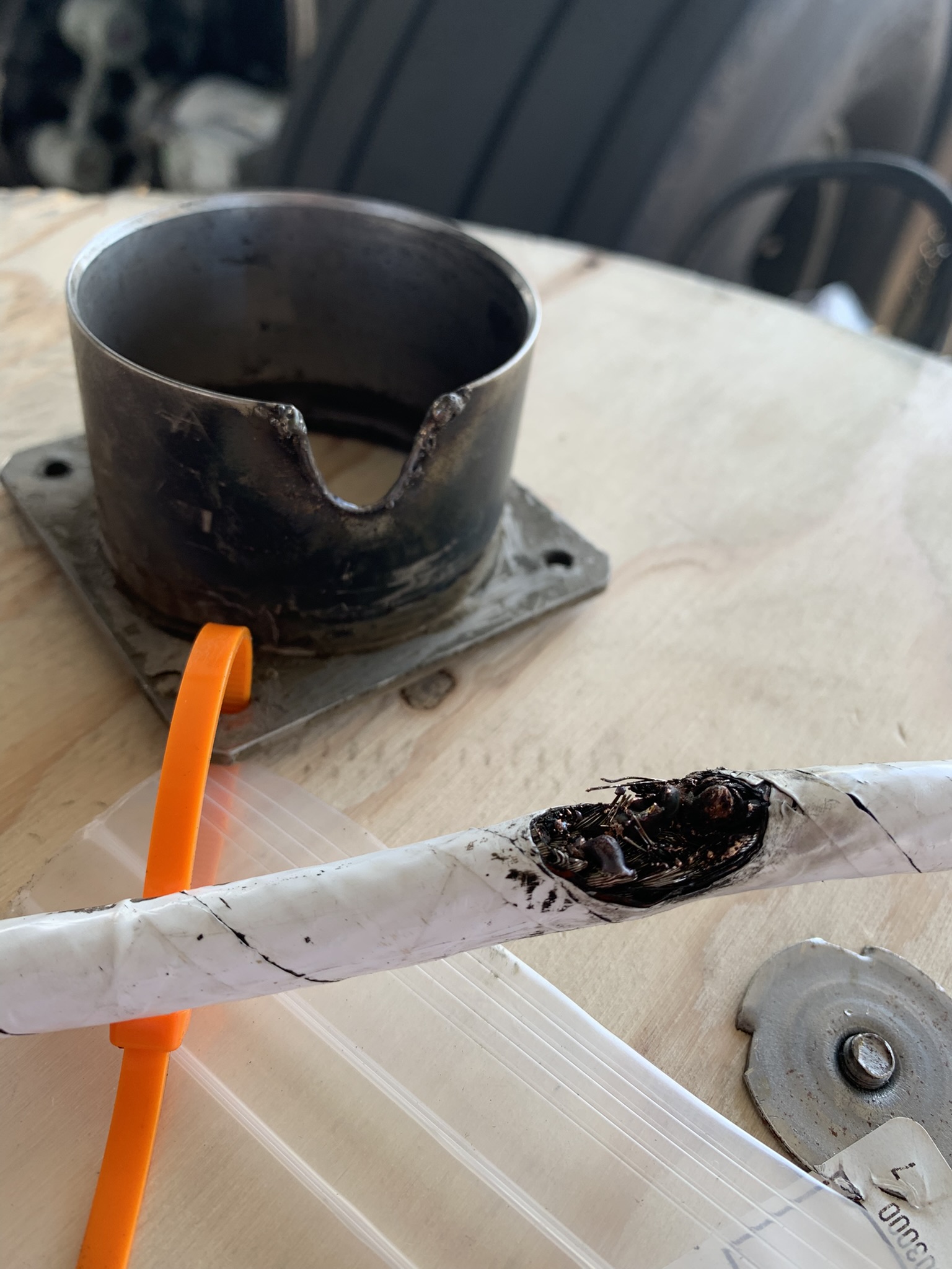

Power Feeder Short
https://rotate.aero/forum/ata24-767/343-ata-24-20-shorted-power-feeder-wire#1893
They just keep coming.....
Feeder 080726
