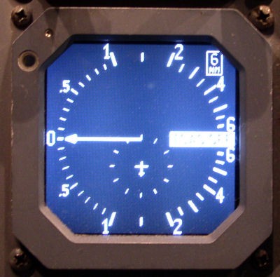

The IVSI control valve should also be left open. The IVSI is used to verify altitude rate of change. As a general rule, never exceed 6000' a minute going up or down.

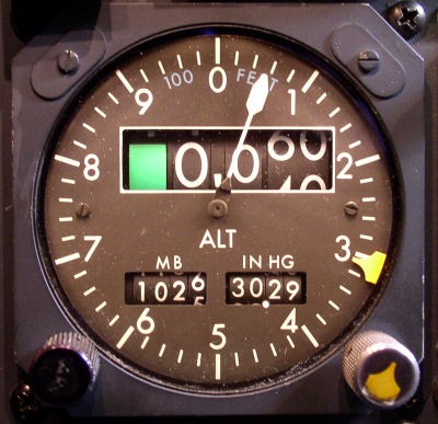

  3. Slowly begin to open the static control valve. The altimeter can be driven to the desired value. The higher altitudes require opening the control valve more on the way up. Keep the IVSI within the 6000’ rate.

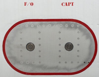

  5. Watch your hoses. Anyone stepping on or tripping over a hose might make it fall off the test port. If an airspeed indicator gets pissed from being driven to fast, an altimeter or air data computer will go into a rage if it is dropped from 40K to 0 all at once.
  6. Keep in mind that both pitot and static are being evacuated. If a small leak is noted in the 35K+ range it is most likely with the test connections or the tape on the opposite side static port. Newer aircraft that have the static port incorporated in the side of the pitot probe do not usually have this problem. I have found that static and pitot test adapters from Nav-Aids® provide a very tight connection.
  7. The system can be lowered by slowly opening the static vent valve. Again, do not exceed the 6000’ rate.
