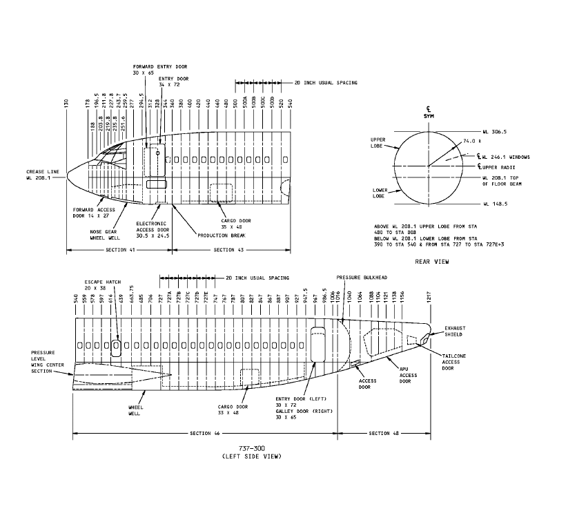

How can you find an specific stringer of fuselage through external inspection?
2 years 9 months ago - 2 years 9 months ago #1398 by Mark
Replied by Mark on topic Finding stringer

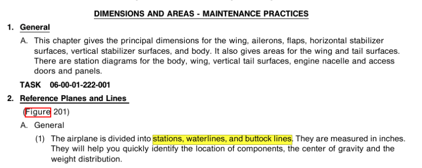

Chapter 6 is your reference for aircraft locations.
This is a (poor) screenshot image from a 737-400. You'll have to reference your Maintenance Manual for a -300.

I have already read chapter 6, however I mean to say how can I physically locate the stringer under fuselage skin?Is it necessary to remove stowage bin,internal insulation ...etc?
