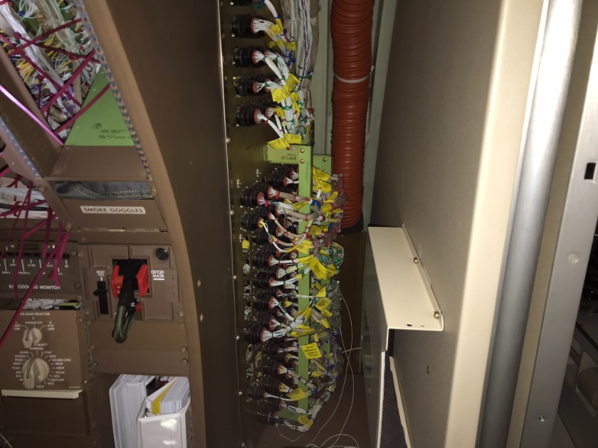

What is disconnect bracket in WDM(91-04)?
2 years 10 months ago #1337 by Mark
Replied by Mark on topic Disconnect Bracket
Panels with connection mounts located throughout the aircraft. These connections are pretty much exclusively jacks where the matching plug(s) would connect.
