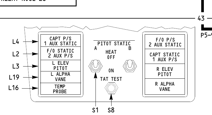

I sent an email and pages of the diagram and the schematic attached with
Do you have any idea on how engine oil pressure signal is fed into the heater control system?
2 years 11 months ago - 2 years 11 months ago #1335 by dynamics
Replied by dynamics on topic Automatic Pitot Heat
I sent just a moment ago 4 files:
1-WDM pre modification
2-WDM post modification (incorporation of modification to make automated air data probe heating system)
3-SSM pre modification
4-Electrical Shelf E3-2 equipments(pre modification)
After modification 3 engine relays are added to the junction box J18 that I can not see how these relays get signal from engine oil pressure switch from the diagrams!??
Last edit: 2 years 11 months ago by dynamics.

2 years 11 months ago #1341 by Mark
Replied by Mark on topic Automatic Pitot Heat
You're getting messed up with all your effectivity aircraft. It looks like some have a manual switch and some are automatic.
Each aircraft's system must be looked at individually. Of the ones which are automatic, air/ground relays control heat.
I'm not digging through all your prints, but I would still suspect that oil pressure plays a part in heating the Capt's and F/O's pitot probes "before" breaking ground. If icing conditions are present, those probes need to be heated for takeoff roll to guarantee proper airspeed indication.

All these sheets are bits and pieces of the circuit. You need to lay them all out and follow each wire. This modification "should" be reflected in the schematic and wiring diagram manuals already.
It's a lot easier to follow everything on the schematics.
