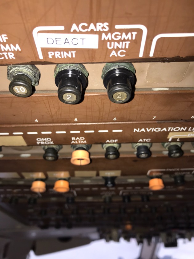

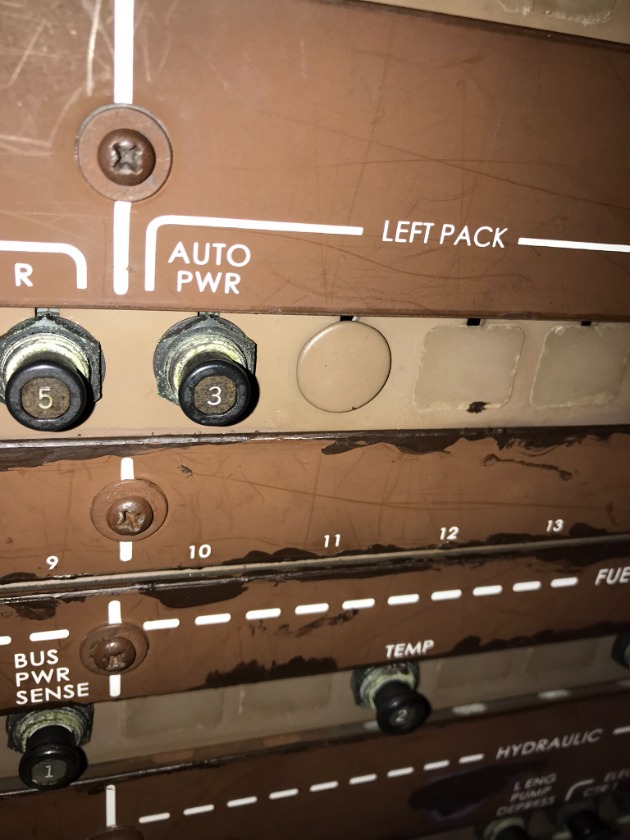

What is the difference of the cap and the collar?
2 years 10 months ago #1333 by Mark
Replied by Mark on topic Circuit Breaker Collar
Black, permanent collar.
Orange, temporary or breaker identifier collar.
The last one is a plug to cover a hole where a breaker was (or a spot where a breaker was never installed.
