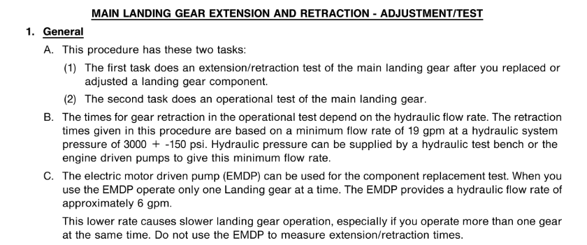

Mark, which components may be the culprits if main gear can be retracted by engine driven pump but it can not be retracted by electrical driven pump?
3 years 5 months ago #1094 by dynamics
Which sort of electrical faults, either in aircraft electrical. system or the electric drive of pump, would make electric motor driven hydraulic pump fail to retract main gear?
3 years 5 months ago - 3 years 5 months ago #1095 by Mark
Look at your Maintenance Manual (32-32-00 Page 501)..... I found this in about 3 minutes.
