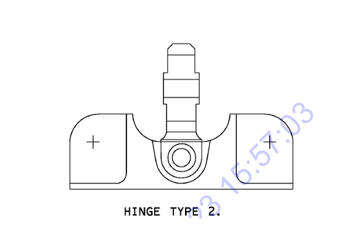

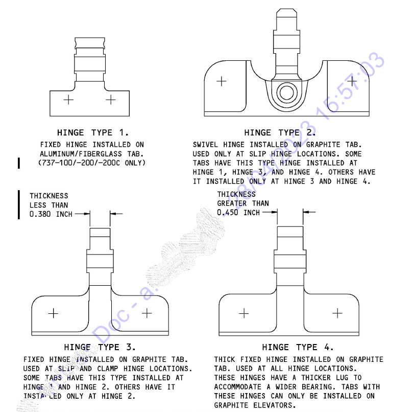

1-with regard to file 1.png, why swivel hinge may be used instead of fixed one at Attachment points of elevator and the tab?
2-would you mind explain thoroughly how is clamped hinge different to the slip hinge?

Please refer to AMM27-31-31(Iemailed) pages 6-12 for hinge configurations, and pages 6,13,17,34,3536 for inspection putty
