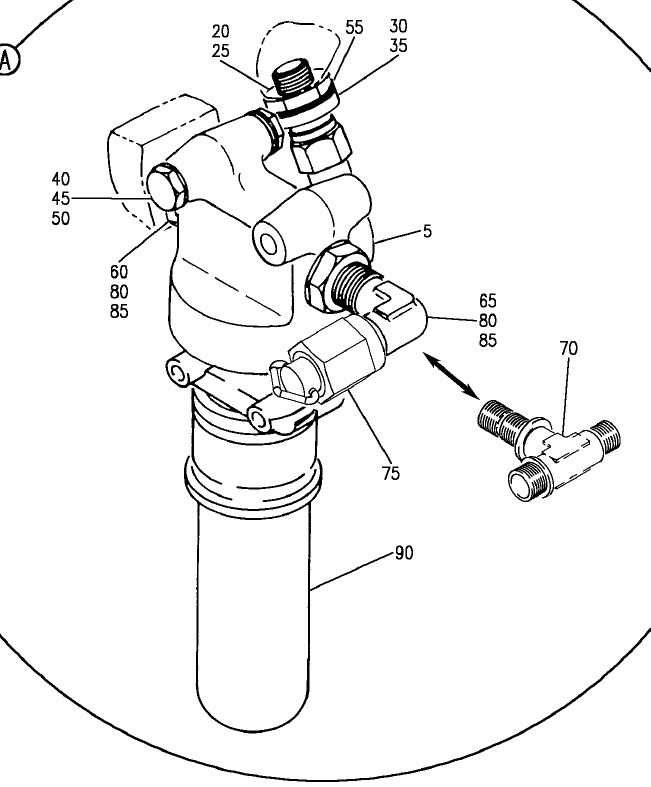

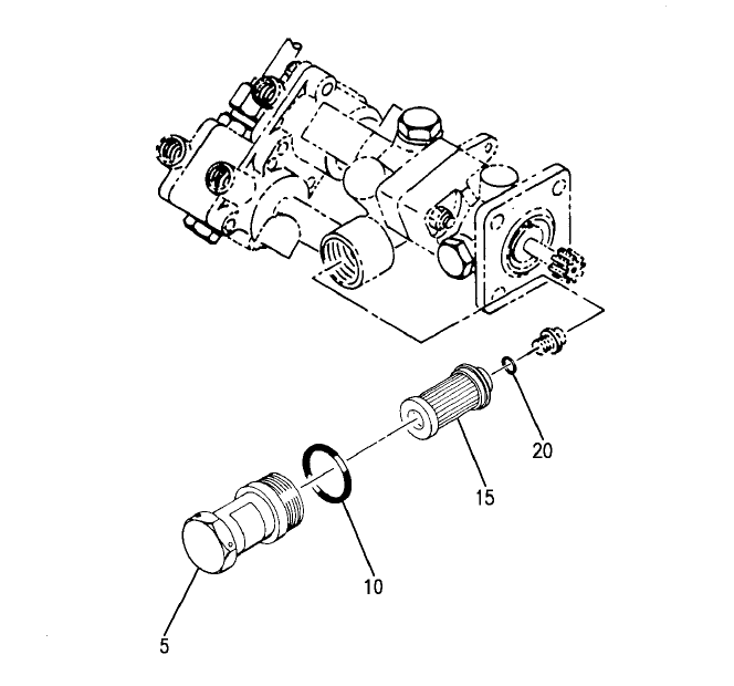

Mark, regarding an email I sent just a moment ago with two files attached, would you agree with me that the filter per file 2 (item90) is the low pressure filter that is connected to the APU fuel control unit as per figure 1 (in which item15 is high pressure filter)?
3 years 7 months ago #953 by Mark
Replied by Mark on topic APU Fuel Control Unit Filters
For other readers..... these are the two filters in question.
I would agree with you. The large vertical filter is a low pressure filter. It is first inline before going into fuel control.
The second would be for the fuel before it hits the nozzles in the combustion chamber.
