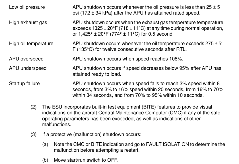

Section 49-00-00-810-801 of the manual you sent me shows all the failure codes that can be read.
I also found this in the manual.....
