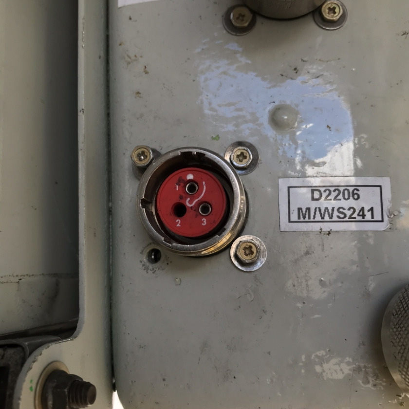

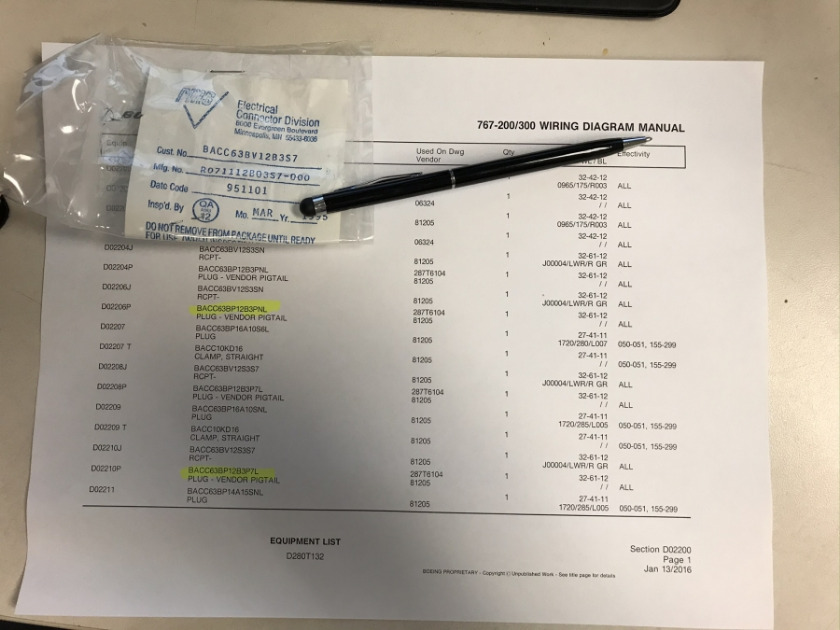

We had a discripency on ordering the right type of plugs for one of the gear junction boxes. Some aircraft had 2206 and 2210 mixed up.
We needed a double master keyway type plug for P2206J when we ordered out of the IPC, we received a single keyway plug.
I'm just adding this to the site for reference: The double keyway plug is actually the 2210 part number.
