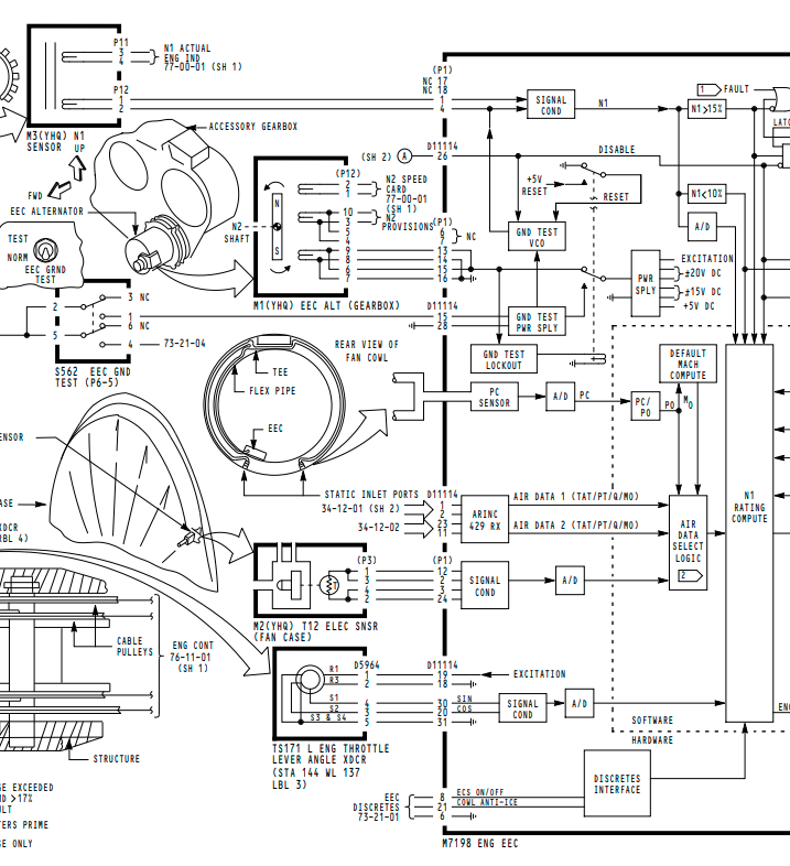

We put a meter to all external inputs and measured the torque coils and feedback wires to the fuel control.

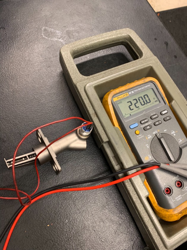

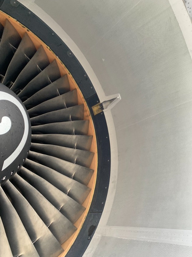

We found the T1.2 temperature sensor reading open. We verified the wires to the sensor plug were good. Resistance readings directly at the probe still had the open.
After a replacement sensor was obtained, we checked resistance. It read 220Ω.
After the replacement and engine run..... all EEC functions checked normal.
