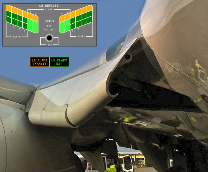

The bussing plugs are mounted to the forward wing spar under the Krueger Flaps.
Those flaps can close quickly and take a person's head off.
Any time someone is working behind the flaps, hydraulics should be locked out. Safety lockouts (if you have them) should also be used.

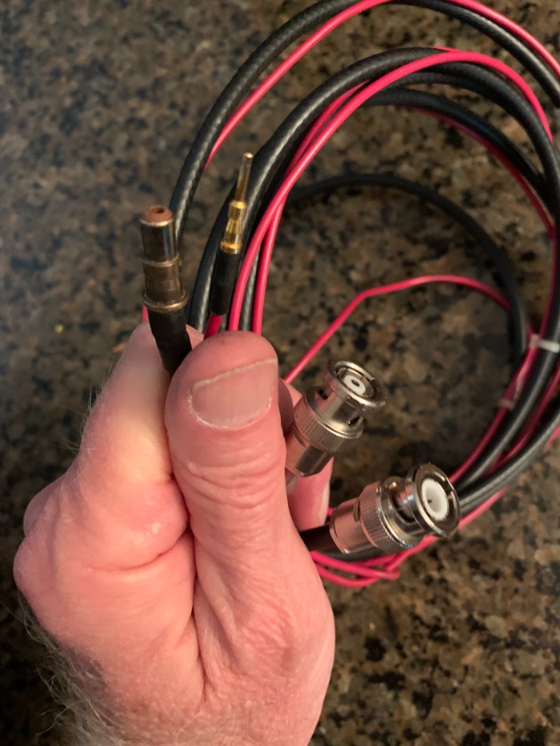

You need a PSD-60 or equivalent fuel quantity test unit. You need the appropriate break-out test cable. You need the test adapter to check individual probes at the bussing plug.
NEVER USE A CONVENTIONAL MEGGER FOR ANYTHING INSIDE THE TANK!!!
1 year 2 months ago #1807 by Mark
Replied by Mark on topic Fuel Quantity Indicator
This is the adapter to check individual probes at the removed bussing unit at the wing spar.
