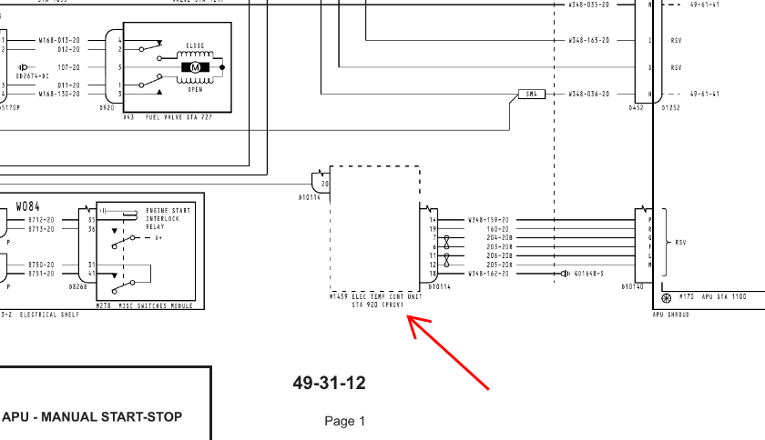

(Prov)-wiring diagram
1 year 6 months ago - 1 year 6 months ago #1725 by dynamics
What does (prov) stand for?
Last edit: 1 year 6 months ago by Mark.
1 year 6 months ago #1727 by Mark
Replied by Mark on topic (Prov)-wiring diagram
Provision or "provisions for" added equipment that has not been installed.
If a customer or airline wants to add the extra equipment, the wiring is already installed.
1 year 6 months ago - 1 year 6 months ago #1729 by dynamics
Replied by dynamics on topic (Prov)-wiring diagram
Are you indicating that the installation of new wiring is not necessary for the deployment of the equipment for which the existing wiring has been provided?
Last edit: 1 year 6 months ago by dynamics.
1 year 6 months ago #1730 by Mark
The provided print shows the wiring and plug are already installed.
The wires have identifying numbers along with the plug having a equipment list number.
All of that "has" been installed unless a engineering order or documented change has been accomplished.
