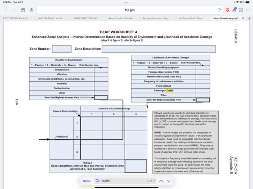

According to a FAA Advisory Notice…. Passenger traffic is noted as an area of concern with wiring.
I’m guessing the same for maintenance traffic.
In other words, areas where people (passenger or maintenance) is brushing up against, stepping on, pulling on….. that might cause wire damage from continued continual contact.

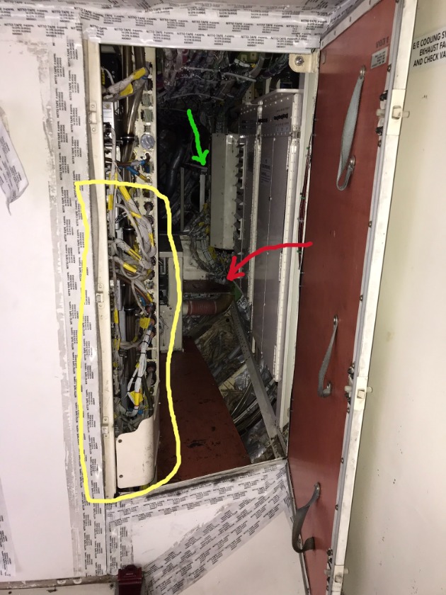

2 years 4 months ago #1522 by Mark
Replied by Mark on topic EWIS
Crossing from lower forward cargo compartment into the electronics bay.
Brushing up on wires circled in yellow.

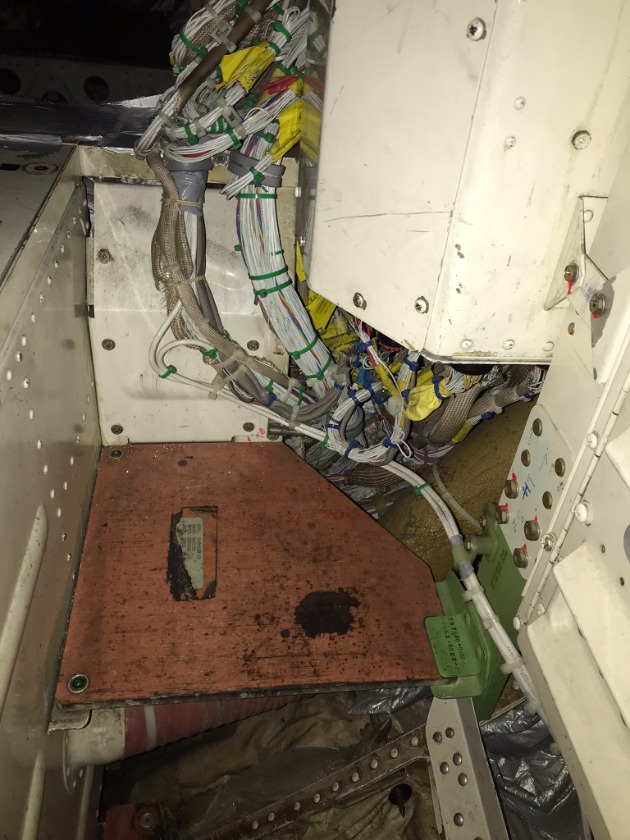

Using step (red arrow) to crawl over structure to get to the oxygen bottles (not seen but in direction of green arrow).
That bundle of wires on right of step gets kicked a lot.
