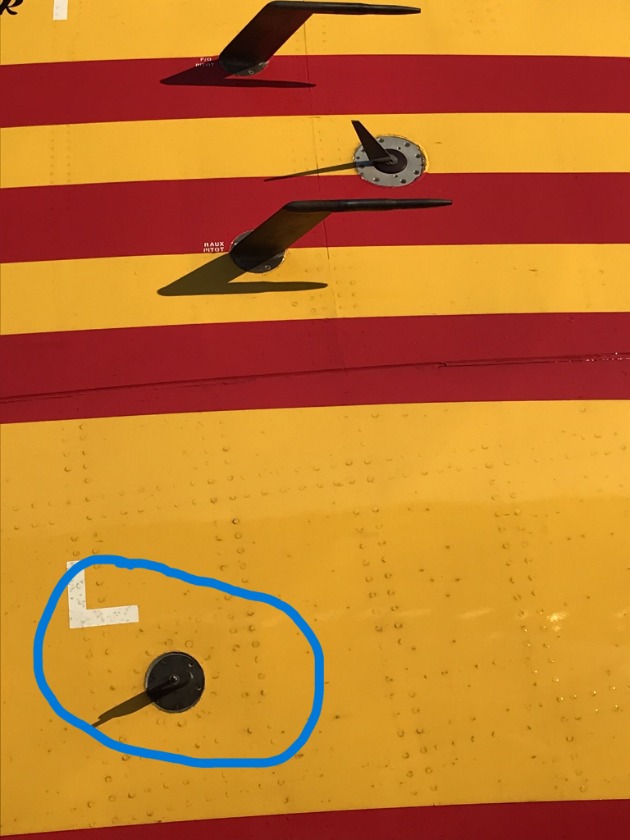

My airline has about twenty five 767 aircraft. Only three have a probe.
It is located forward right, just aft and below the right pitot probes.
I'll get a pick when I can.

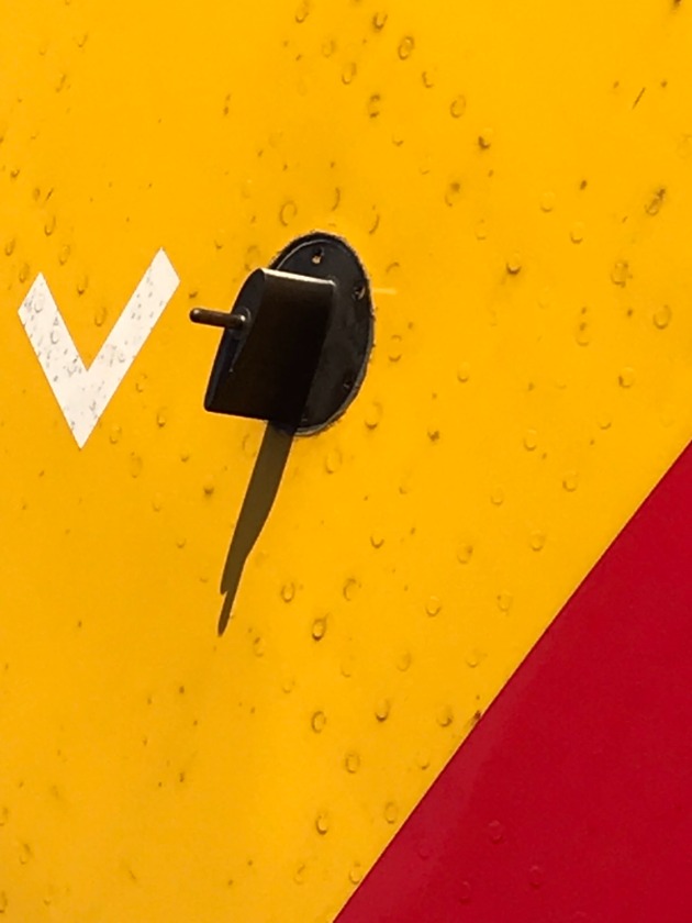

2 years 5 months ago #1506 by Mark
Replied by Mark on topic Ice detector probe
Aircraft right side. Just below aft cockpit window.
