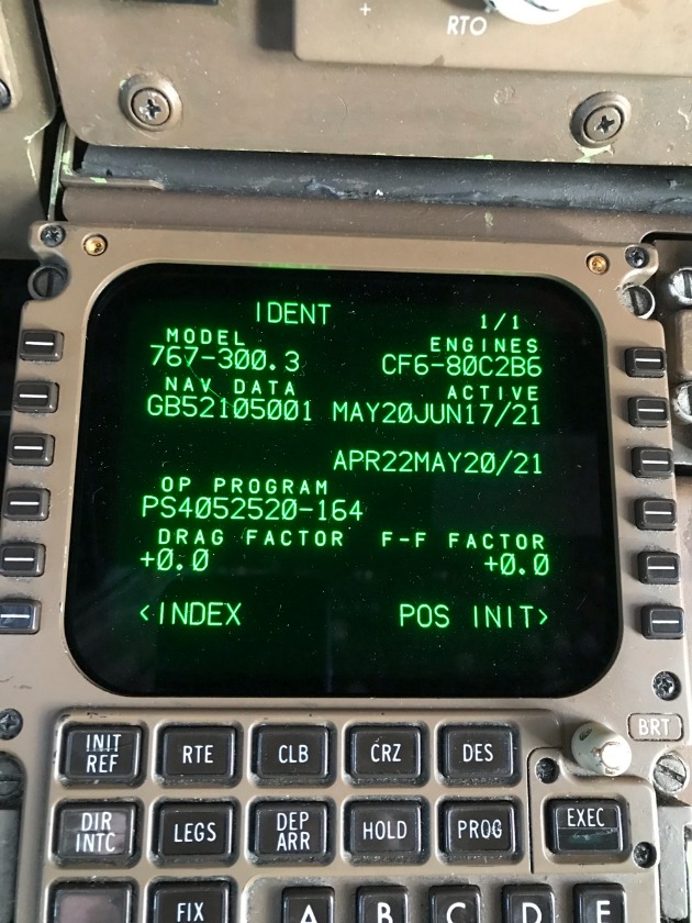

Ident Screen

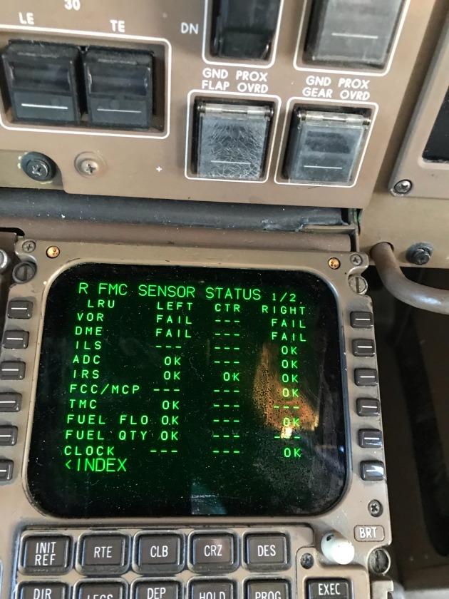

Looking at the "Sensors" page, it was noticed that both VOR and both DME inputs were valid.

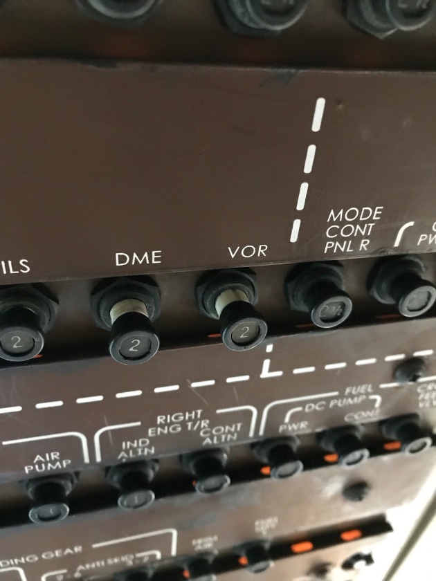

Pulling the breakers for the VOR receivers and the DME interrogators.....
Resulted in the data bus outputs from those units to fail.

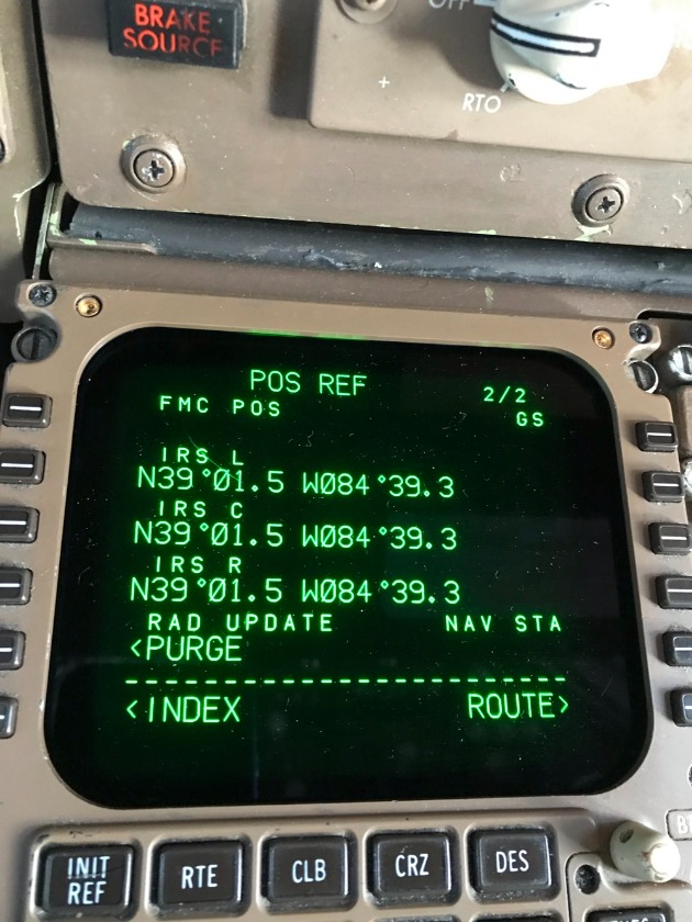

Digging through the menus, I also found a purge function (not sure what it does).

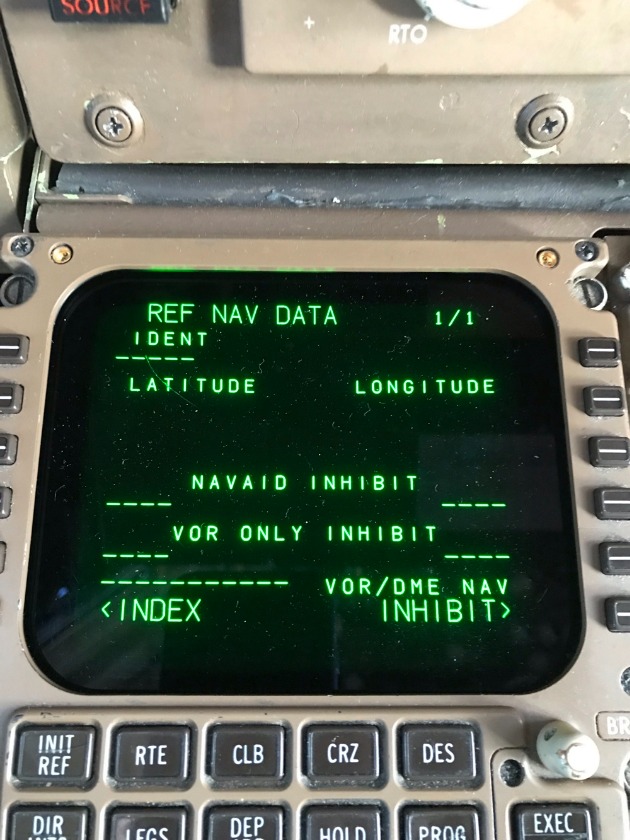

I also noticed that the navigation aids can be completely turned off.
All navigation inputs seemed to be correct. I was running out of ideas, so the thought was that the last database load was bad. Before I started a reload..... I noticed the "active" database was the wrong date for the current date (check out the first picture above). The FMS''s were trying to access radio data that was not considered valid, so it threw it out and went to IRS information only. After swapping the databases..... no more write-ups.
As a note: When database updates are done, the future database and the current one are loaded. The system should switch at 00:00 Zulu of the new date. Sometimes they have to be flipped manually.
