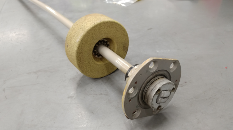

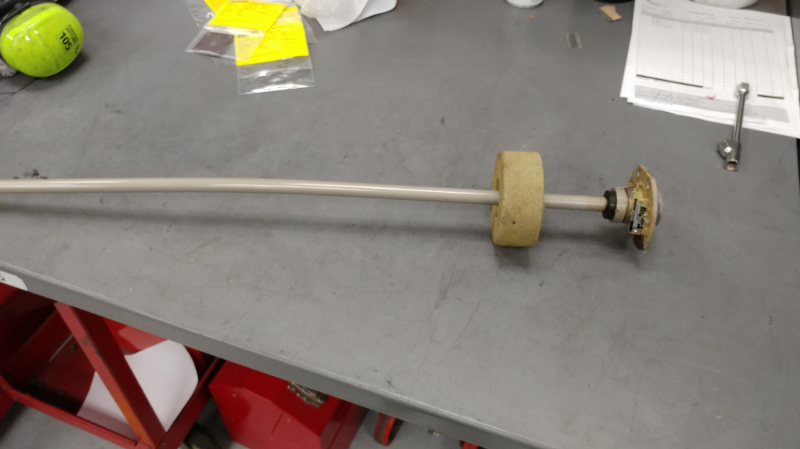

Removed fuel tank stick assembly. Outer case is bent which prevented free movement of the stick itself.
The fuel float (or donut) rides up/down with the fuel level. The internal fuel stick will slightly bounce and remain in place when it is dropped for a tank measurement.
