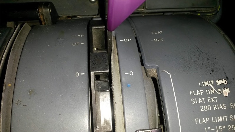

On the MD11 flap quadrant there is a small plastic plug by the blue dot that has to be there. It is removed for rigging purposes, but must be replaced after work is done. Pilots sometime find this missing and its a NO GO!

I have never noticed it. I certainly will check it out though!!

Small black square at top of ramp??? I had to stare at it for a second.

Yes, across from Blue Dot. I have seen them colored white too. This took us by surprise the first time this plug was missing!!
