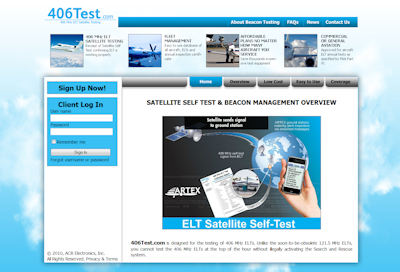

Testing of 406 ELT's usually require a special tester, www.edmo.com/index.php?module=products&f...isplaycat&catid=1640 , these range in price from $1500 to $3000, but ................ there "is" another way to get it done.
Visit www.406test.com/home.aspx?ReturnUrl=%2fmain%2faviation.aspx $30 for registration and $30 per test. Not a bad deal and the procedure takes about 10 seconds, if that. Sweet!!!
