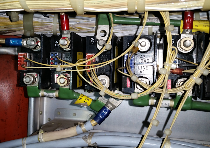

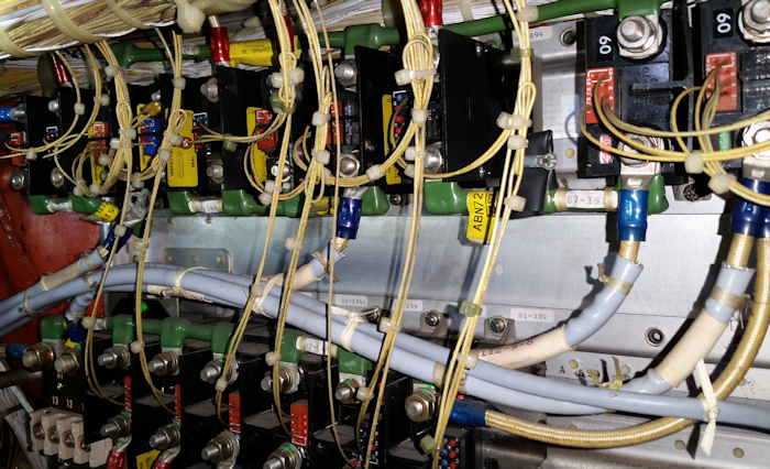

7 years 9 months ago - 7 years 9 months ago #571 by Mark
Replied by Mark on topic MD-11 Auto-Pilot EPCU Fault
rotate.aero/forum/ata-24-electrical-gene...ccb-power-control#63 should explain things for you.
On the MD-10/11, these particular ones were in the forward E&E aft right wall. The majority of the power RCCB's are in the mid electrical bay, forward wall behind the three tall brown covers.
Last edit: 7 years 9 months ago by Mark.
