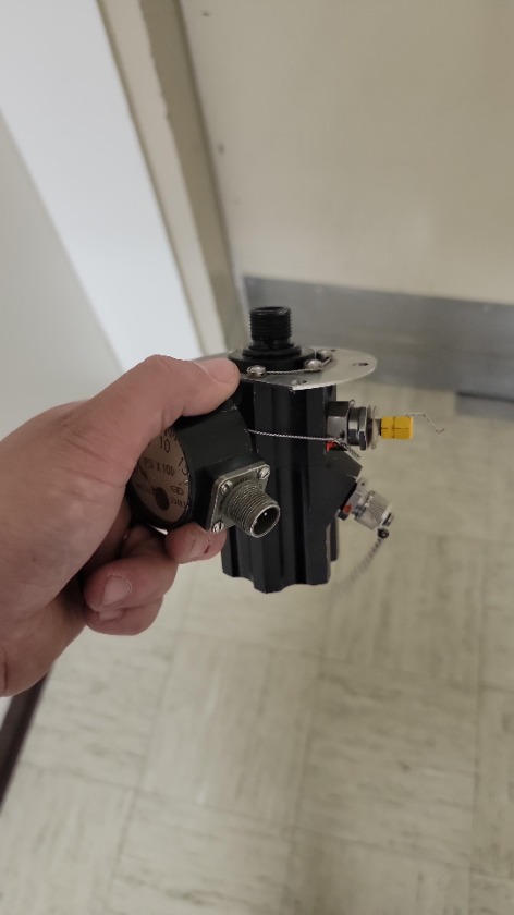

 After checking further into the manual, I see that there is a note saying if the APU fire bottle pressure reads zero the APU wont start. So easy to check and oddly enough the APU fire bottle read zero.  So, issue was found easily but not sure how the bottle would have been blown between starts. I replaced the bottle and made sure to double check the squib activation to make sure it wouldn’t be inadvertently set off. All wiring checks good from the APU fire switch the squib connector. Attach everything and the APU starts up and works properly.

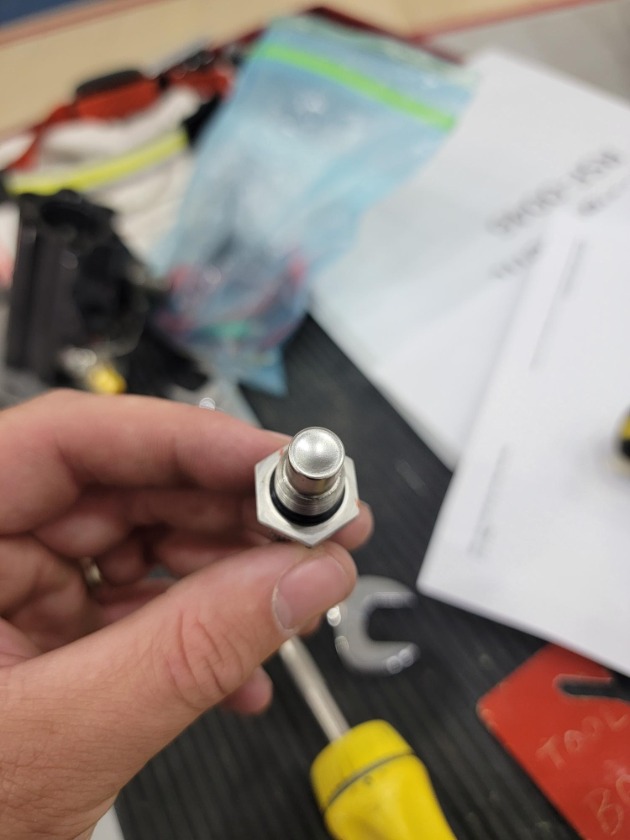

 I’m trying to figure out how this happened so we disassembled the old fire bottle and I find out that the squib was never blown yet the bottle was blown. I figured it must have been a thermal discharge.

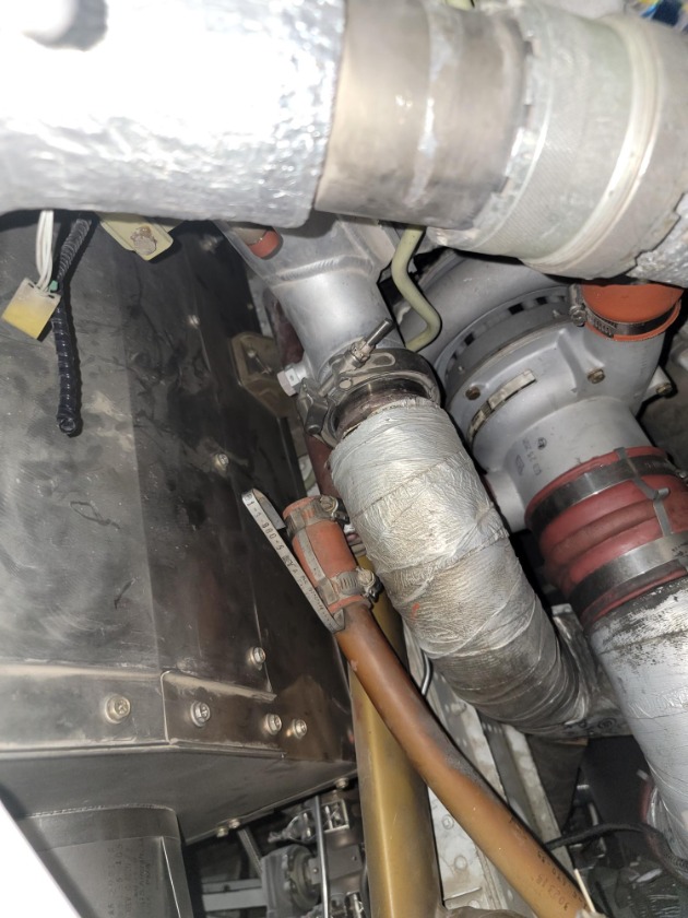

 Restarted the APU to trouble shoot further and found an open hot air duct that was putting hot air onto the fire bottle causing the bottle to blow.
We reconnected the line and have had no issues since. What made this odd is that we were with the airplane the entire time and no one noticed the APU bottle blow and the APU never shutdown, so that threw us off at the start.

They have the WDM online but not aircraft specific so 75% of the time your going to the old paper copy to find out how the airplane was completed. There was no reference to a thermal discharge but there was a metal shard that looked like it was originally the cap to the bottle, not sure if it was made to let go at a certain temperature or the bottle just got so hot and overpressurized. Doesn't help when ambient temp is 120 + running the apu with a duct leak.
