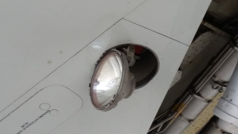

When you do your walk-around, you see this....

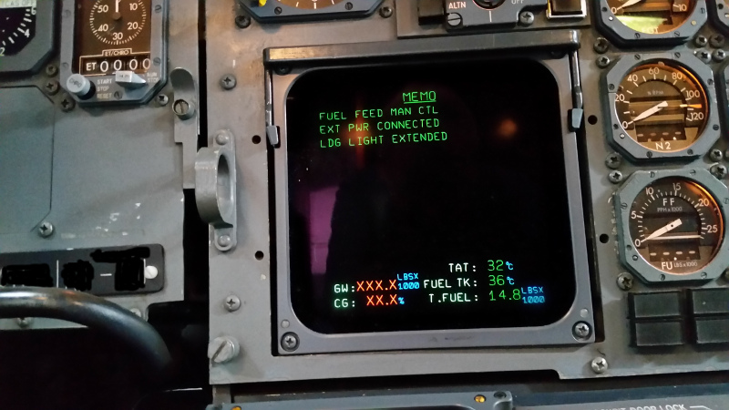

When you power-up, you see this....

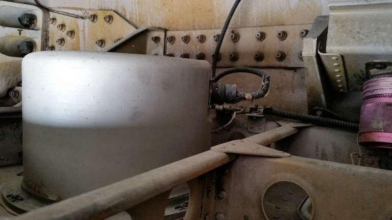

The ground signal for ECAM landing light extended comes from the light assembly itself. The left and right lights are wired in parallel. You've got a 50-50 chance when you take the first "can" plug off.
It's a real quick repair. About 10 screws and out she comes.

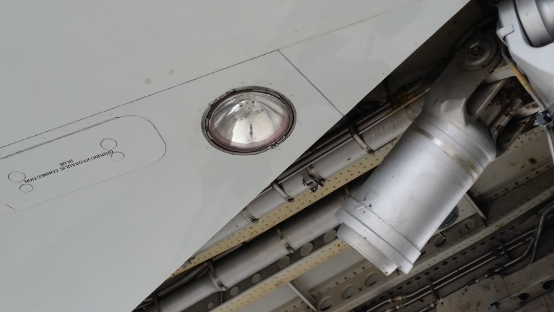

New light extended....
