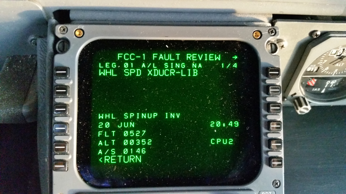

A recent MD-10-10 inbound aircraft had a repeat write-up of a "Single Land" warning right after rotation. A quick look into the CFDS, FCC1 and FCC2 flight faults showed numerous wheel speed transducer faults.
The Auto-Pilot uses wheel speed signals to initiate the nose-down and roll-out landing functions. The FCC's look for 80 knot wheel speed signals during take-off. The thinking is...... if one (or more) transducers is failed at the beginning of flight, than the failure will be present on landing which would prevent proper auto-land operations.

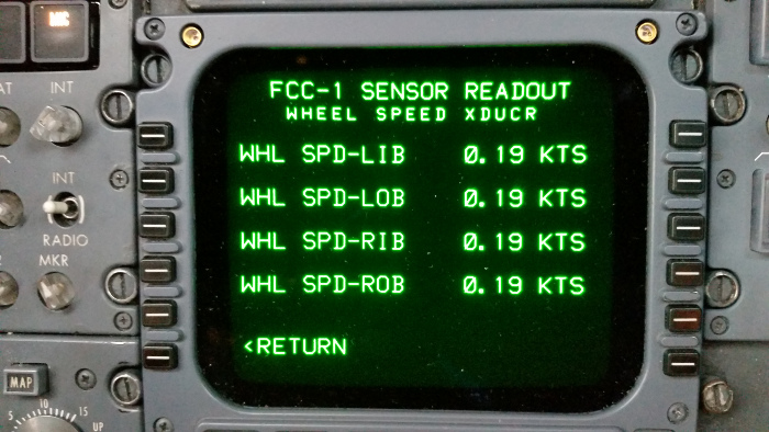

The transducers can be monitored through CFDS, FCC1 (or FCC2), Sensor Readout, Analog Inputs.
The left inboard does show "something" in the image above, but all the tires are at rest. The failure would most likely be either a sheared transducer shaft or a open signal coil. There would be no speed increase as with the other three tires. The FCC's would log this fault almost instantly. All the flights referenced for this failure had the fault recorded before 500' of altitude.
