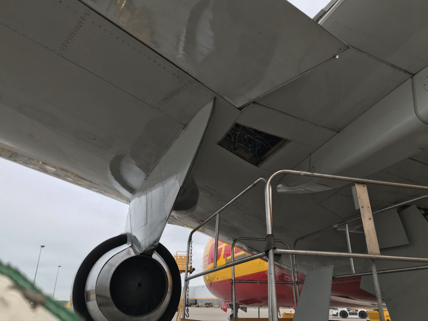

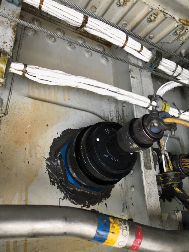

Wing tank fuel quantity bussing plug. Panel located just inboard of pylon trailing edge.

What does that electrical connector use as a means of locking? And I was surprised to see that cording was still used as a harness tie! I think when I went to A&P school, nylon tie wraps weren't invented yet!

These plugs are "supposed" to be snugged with cannon plug pliers or a wrench. Then safety wired in the tight direction..
The safety wire on this plug was backwards. It was not tight, but not completely loose either. When I secured it correctly, our failed fuel quantity indication problem operated normal.
Images of plug.
