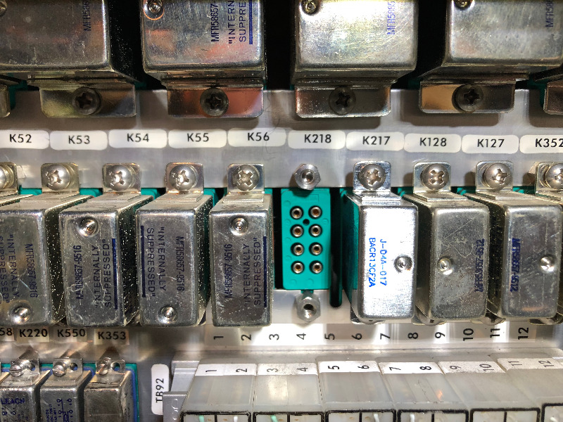

Intermittent EICAS failure warning of the Auto-Speedbrake system.
Found an associated relay K218 (P33 Panel) that had a bad coil. It would act like a car blinker. The coil got hot and went open. It would cool down again and activate the relay.
767-300 WDM 27-62-11
