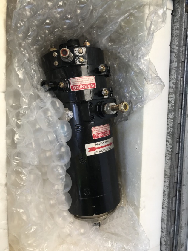

APU doesn't start.
Replaced starter. It turns, but no APU spin.
Replaced clutch. No Help
Found original replacement starter spinning backwards. Put it on car battery. It spun backwards no matter if positive/negative swapped.
I've seen some strange-ass stuff over the years..... never a backwards starter fresh from the shop.
