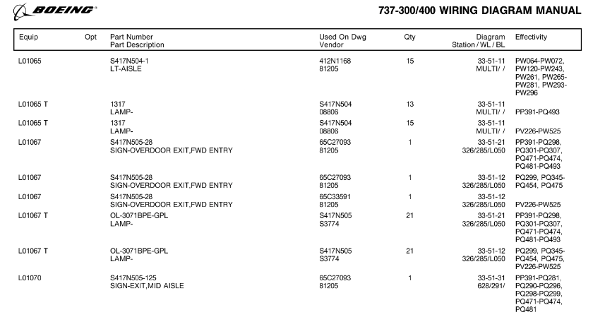

In concern with emergency lighting system, what is the purpose of placards? and furthermore there is an ambiguous code (e.g L1067) in their text content (e.g. "L1067 OVERDOOR EXIT SIGN"), so what does the code mean?

Placards are just informational notes for particular systems or locations.
As far as L1067, from the equipment list....
