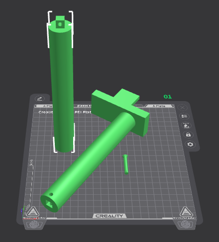

I found it very annoying installing the pitot static covers on G650 aircraft especially while on the road. The upper Pitot static ports are just out of reach end up trying to stand on a chock my shirt gets un tucked ect. The gulfstream tool is way to big comes on a giant pole have to store it in the cargo and we are typically max load. I have found this tool much quicker and more convenient. I added an extra extension in case you are shorter. This is version 1 of this tool, I would like to design a handle that folds or extends in and out to make it quicker easier and smaller, but still testing different ideas. I printed mine out of ABS plastic for strength but i feel that any type would be suitable for this print.
Print time: 6:00
Print Cost: $2.00
Plastic Type: Any
